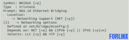

2.3568/OK3568-linux-source/kernel下执行make ARCH=arm64 menuconfig
搜索CONFIG_BRIDGE,将其选成Y
