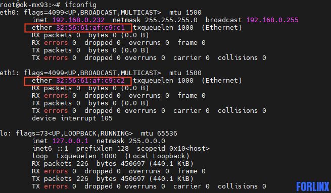

1.ifconfig查看网口mac地址

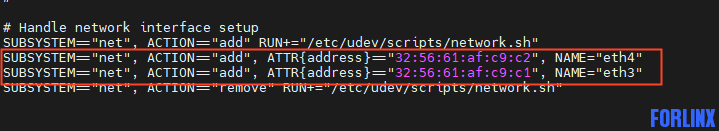

2.修改/etc/udev/rules.d/autonet.rules文件,添加如下语句,根据mac地址修改网口名称
SUBSYSTEM=="net", ACTION=="add", ATTR{address}=="32:56:61:af:c9:c2", NAME="eth4"
SUBSYSTEM=="net", ACTION=="add", ATTR{address}=="32:56:61:af:c9:c1", NAME="eth3"
修改完后,sync保存重启

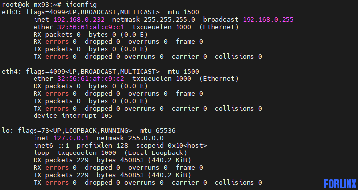

网口名称修改成功
