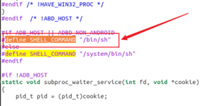

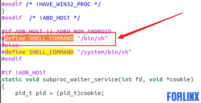

1.修改源码:vi /OK3568-linux-source/buildroot/output/OK3568/build/android-tools-4.2.2+git20130218/core/adbd/services.c
-#define SHELL_COMMAND "/bin/sh"
+#define SHELL_COMMAND "/bin/adb_shell"
