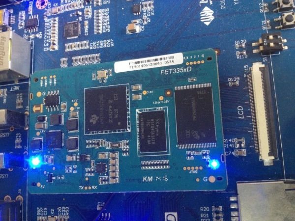

发表于 2016-6-20 10:37:17 | 显示全部楼层 |阅读模式
Writing NK image to OS partition
ROMHDR (pTOC = 0x84ac0380) ---------------------
  DLL First           : 0x4001eef8
  DLL Last            : 0x4357f000
  Physical First      : 0x80002000
  Physical Last       : 0x84ac44c8
  Num Modules         :        377
  RAM Start           : 0x84ad0000
  RAM Free            : 0x84ae5000
  RAM End             : 0x8d000000
  Num Copy Entries    :          2
  Copy Entries Offset : 0x8094ddc0
  Prof Symbol Length  : 0x00000000
  Prof Symbol Offset  : 0x00000000
  Num Files           :        163
  Kernel Flags        : 0x00000000
  FileSys RAM Percent : 0x0a0a0a0a
  Driver Glob Start   : 0x00000000
  Driver Glob Length  : 0x00000000
  CPU                 :     0x01c2
  MiscFlags           :     0x0002
  Extensions          : 0x80003020
  Tracking Mem Start  : 0x00000000
  Tracking Mem Length : 0x00000000
IsValidMBR: MBR sector = 0x18940 (valid MBR)
OpenPartition: Partition Exists=0x0 for part 0x20.
ERROR: OS partition not found!
BLAutoWriteNK fail..
                    Write XLDR error!
Hit space to enter configuration menu [25113] 5...
Hit space to enter configuration menu [26113] 4...
Hit space to enter configuration menu [27113] 3...
Hit space to enter configuration menu [28113] 2...
Hit space to enter configuration menu [29113] 1...
g_eboot.bootDeviceType 2
Please choose boot NK device!
905
743
发表于 2016-6-20 14:20:26 | 显示全部楼层
您好,请检查您的电源输出功率是否充足。如果输出正常请将开发板寄回我们为您检查一下是否为硬件问题。
