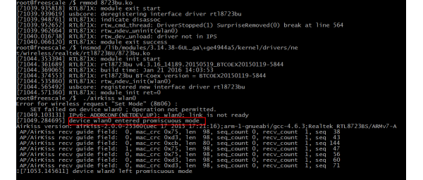

发表于 2017-7-26 14:24:49 | 显示全部楼层 |阅读模式

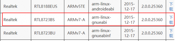

1.airkiss静态库
http://iot.weixin.qq.com/wiki/new/index.html?page=4-1-4
2.切换信道函数:
void switch_channel_callback(void)
  char buf[50] ={0};
   if(g_channel >= MAX_CHANNELS)
           g_channel = 1;
   }else
           g_channel++;
   sprintf(buf,"iwconfig wlan0 channel %d",g_channel);
   system(buf);
   airkiss_change_channel(&akcontex);
3.启动airkiss后的log信息。就是无法锁定信道,网卡确实已经进入monitor模式!!
有遇到类似情况吗???
