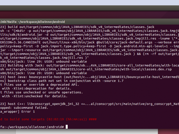

整个流程完全按照文档写的操作,lichee编译成功,android编译报错。麻烦看下什么原因

Starting build with ninja
ninja: Entering directory `.'
[  0% 99/24865] Ensure Jack server is installed and started
Writing client settings in /root/.jack-settings
Installing jack server in "/root/.jack-server"
Warning:
The JKS keystore uses a proprietary format. It is recommended to migrate to PKCS12 which is an industry standard format using "keytool -importkeystore -srckeystore /root/.jack-server/server.jks -destkeystore /root/.jack-server/server.jks -deststoretype pkcs12".
Warning:
The JKS keystore uses a proprietary format. It is recommended to migrate to PKCS12 which is an industry standard format using "keytool -importkeystore -srckeystore /root/.jack-server/client.jks -destkeystore /root/.jack-server/client.jks -deststoretype pkcs12".
Launching Jack server java -XX:MaxJavaStackTraceDepth=-1 -Djava.io.tmpdir=/tmp -Dfile.encoding=UTF-8 -XX:+TieredCompilation -Xmx4096m -cp /root/.jack-server/launcher.jar com.android.jack.launcher.ServerLauncher
[  0% 102/24865] build out/target/common/obj/JAVA_LIBRARIES/bms_intermediates/classes.jack
FAILED: /bin/bash -c "(mkdir -p out/target/common/obj/JAVA_LIBRARIES/bms_intermediates/classes.jack.tmpjill.res ) && (unzip -qo vendor/aw/public/prebuild/lib/libbms/bms.jar -d out/target/common/obj/JAVA_LIBRARIES/bms_intermediates/classes.jack.tmpjill.res ) && (find out/target/common/obj/JAVA_LIBRARIES/bms_intermediates/classes.jack.tmpjill.res -iname \"*.class\" -delete ) && (JACK_VERSION=3.36.CANDIDATE out/host/linux-x86/bin/jack @build/core/jack-default.args --verbose error  -D jack.import.resource.policy=keep-first -D jack.import.type.policy=keep-first -D jack.android.min-api-level=1 --import vendor/aw/public/prebuild/lib/libbms/bms.jar --import-resource out/target/common/obj/JAVA_LIBRARIES/bms_intermediates/classes.jack.tmpjill.res --output-jack out/target/common/obj/JAVA_LIBRARIES/bms_intermediates/classes.jack ) && (rm -rf out/target/common/obj/JAVA_LIBRARIES/bms_intermediates/classes.jack.tmpjill.res )"
out/host/linux-x86/bin/jack: line 29: USER: unbound variable
[  0% 102/24865] Building with Jack: out/target/common/obj/JAVA_LIBRARIES/core-all_intermediates/with-local/classes.dex
FAILED: /bin/bash out/target/common/obj/JAVA_LIBRARIES/core-all_intermediates/with-local/classes.dex.rsp
[  0% 102/24865] build out/target/common/obj/JAVA_LIBRARIES/sdk_v8_intermediates/classes.jack
FAILED: /bin/bash -c "(mkdir -p out/target/common/obj/JAVA_LIBRARIES/sdk_v8_intermediates/classes.jack.tmpjill.res ) && (unzip -qo prebuilts/sdk/8/android.jar -d out/target/common/obj/JAVA_LIBRARIES/sdk_v8_intermediates/classes.jack.tmpjill.res ) && (find out/target/common/obj/JAVA_LIBRARIES/sdk_v8_intermediates/classes.jack.tmpjill.res -iname \"*.class\" -delete ) && (JACK_VERSION=3.36.CANDIDATE out/host/linux-x86/bin/jack @build/core/jack-default.args --verbose error  -D jack.import.resource.policy=keep-first -D jack.import.type.policy=keep-first -D jack.android.min-api-level=1 --import prebuilts/sdk/8/android.jar --import-resource out/target/common/obj/JAVA_LIBRARIES/sdk_v8_intermediates/classes.jack.tmpjill.res --output-jack out/target/common/obj/JAVA_LIBRARIES/sdk_v8_intermediates/classes.jack ) && (rm -rf out/target/common/obj/JAVA_LIBRARIES/sdk_v8_intermediates/classes.jack.tmpjill.res )"
ninja: build stopped: subcommand failed.
make: *** [ninja_wrapper] Error 1
#### make failed to build some targets

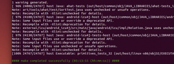

 楼主| 发表于 2019-11-24 08:36:53 | 显示全部楼层
自己解决了,USER环境变量问题,需要export USER=$(whoami)就可以了
