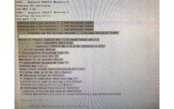

使用的手册是v1.1_2019.07.30版本,现在我插入u盘启动,没有自动烧写,还是直接起来了,过程中有如图打印  详情 回复 发表于 2019-12-20 15:08
scanning bus 0 for devices... 2 USB Device(s) found scanning bus 1 for devices... 1 USB Device(s) found scanning bus 2 for devices... 1 USB Device(s) found scanning usb for storage devices..  详情 回复 发表于 2019-12-20 15:19

 楼主| 发表于 2019-12-20 15:19:56 | 显示全部楼层
       scanning usb for storage devices... 1 Storage Device(s) found
Device 0: Vendor: SanDisk Rev: 1.00 Prod: Ultra USB 3.0
            Type: Removable Hard Disk
            Capacity: 14663.6 MB = 14.3 GB (30031250 x 512)
... is now current device
** Unrecognized filesystem type **
switch to partitions #0, OK
mmc0(part 0) is current device
Scanning mmc 0:2...
Found U-Boot script /boot/ls1043ardb_boot.scr
872 bytes read in 18 ms (46.9 KiB/s)
## Executing script at 80000000
** Unable to read file /boot/uEnv.txt **
21522944 bytes read in 1102 ms (18.6 MiB/s)
29406 bytes read in 17 ms (1.6 MiB/s)
## Flattened Device Tree blob at 90000000
   Booting using the fdt blob at 0x90000000
   Using Device Tree in place at 0000000090000000, end 000000009001a2dd

1046是吧,图看不清,把打印信息整个复制下来

 楼主| 发表于 2019-12-20 15:35:55 | 显示全部楼层
localhost login:
U-Boot 2018.03 (Aug 15 2019 - 01:53:03 +0000)
SoC:  LS1043AE Rev1.1 (0x87920211)
Clock Configuration:
       CPU0(A53):1600 MHz  CPU1(A53):1600 MHz  CPU2(A53):1600 MHz
       CPU3(A53):1600 MHz
       Bus:      400  MHz  DDR:      1600 MT/s  FMAN:     500  MHz
       00000000: 08100010 0a000000 00000000 00000000
       00000010: 14550002 80004012 40044000 c1002000
       00000020: 00000000 00000000 00000000 00238800
       00000030: 20044500 00001102 00000096 00000001
Model: OK1043-C
Board: LS1043ARDB, boot from QSPI
SERDES Reference Clocks:
SD1_CLK1 = 156.25MHZ, SD1_CLK2 = 100.00MHZ
I2C:   ready
DRAM:  Initialzing DDR using fixed setting
Configuring DDR for 1600 MT/s data rate
1.9 GiB (DDR4, 32-bit, CL=11, ECC off)
DS2460 OK
Using SERDES1 Protocol: 5205 (0x1455)
SEC0: RNG instantiated
PPA Firmware: Version LSDK-18.06-Forlinx
SEC Firmware: 'loadables' present in config
loadables: 'trustedOS@1'
MMC:   FSL_SDHC: 0
Loading Environment from SPI Flash... SF: Detected n25q128 with page size 256 Bytes, erase size 64 KiB, total 16 MiB
OK
In:    serial
Out:   serial
Err:   serial
SATA link 0 timeout.
AHCI 0001.0301 32 slots 1 ports 6 Gbps 0x1 impl SATA mode
flags: 64bit ncq pm clo only pmp fbss pio slum part ccc apst
Found 0 device(s).
SCSI:  Net:   SF: Detected n25q128 with page size 256 Bytes, erase size 64 KiB, total 16 MiB
Fman1: Uploading microcode version 106.4.18
PCIe0: pcie@3400000 disabled
PCIe1: pcie@3500000 Root Complex: no link
PCIe2: pcie@3600000 Root Complex: no link
FM1@DTSEC1, FM1@DTSEC2, FM1@DTSEC3 [PRIME], FM1@DTSEC4, FM1@DTSEC5, FM1@DTSEC6, FM1@TGEC1
starting USB...
USB0:   Register 200017f NbrPorts 2
Starting the controller
USB XHCI 1.00
USB1:   Register 200017f NbrPorts 2
USB XHCI 1.00
USB2:   Register 200017f NbrPorts 2
USB XHCI 1.00
Scanning mmc 0:2...
Starting kernel ...

发表于 2019-12-20 16:26:48 | 显示全部楼层
系统文件没有识别,用软件格式化u盘,比如HPUSBFW.EXE,重新烤镜像到u盘
谢谢,格式化之后烧写就正常了。我看文档中描述烧写完成后需要配置一些命令,这些配置命令每次烧写后都需要执行吗?这些功能或这些配置能在制作镜像时就加入吗?  详情 回复 发表于 2019-12-20 17:44
22
53
 楼主| 发表于 2019-12-20 17:44:53 | 显示全部楼层
发表于 2019-12-21 09:01:27 | 显示全部楼层
每次烧写后都需要执行,您可自行尝试将其加入到镜像中,我们暂时没有做过
