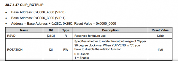

请问有哪位用到 4418 里面 摄像头output image  旋转90度的 ,直接在寄存器设置 的那个功能 ,我这边试了,但是都没有效果,旋转不了
38.7.1.47 CLIP_ROTFLIP
Base Address: 0xC006_4000 (VIP 0)
Base Address: 0xC006_3000 (VIP 1)
Address = Base Address + 0x28C, 0x28C, Reset Value = 0x0000_0000
Name Bit Type Description Reset Value
RSVD [31:3] R Reserved for future use. 13'b0
ROTATION [2] RWSpecifies whether to rotate the output image of Clipper
90 degree clockwise. When YUYVENB is "0", you
have to disable the rotation function.
0 = Disable
1 = Enable
1'b0
VFLIP [1] RWSpecifies whether to flip the output image of Clipper
vertically.
0 = Disable
1 = Enable
1'b0
HFLIP [0] RWSpecifies whether to flip the output image of Clipper
horizontally.
0 = Disable
1 = Enable
1'b0
发表于 2020-4-22 15:00:15 | 显示全部楼层
这个我们没有做过,您可以看看摄像头的手册,看看需要改哪些内容,再根据开发板的资料进行修改
已经按照datasheet上说的去修改了,但是没有效果  详情 回复 发表于 2020-4-23 10:38

 楼主| 发表于 2020-4-23 10:38:55 | 显示全部楼层
