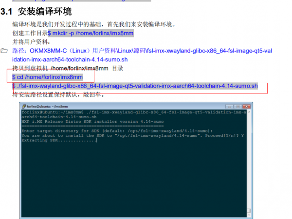

按步骤安装编译环境时,给出这个提示怎么解决啊???
penny@ubuntu:/mnt/hgfs/OKMX8MM-C-Linux/Linux/Source$ su root
Password:
root@ubuntu:/mnt/hgfs/OKMX8MM-C-Linux/Linux/Source# ./fsl-imx-xwayland-glibc-x86_64-fsl-image-qt5-validation-imx-aarch64-toolchain-4.14-sumo.sh
NXP i.MX Release Distro SDK installer version 4.14-sumo
Enter target directory for SDK (default: /opt/fsl-imx-xwayland/4.14-sumo):
You are about to install the SDK to "/opt/fsl-imx-xwayland/4.14-sumo". Proceed[Y/n]? Y
Extracting SDK......................xz: (stdin): Unexpected end of input
tar: Unexpected EOF in archive
tar: Error is not recoverable: exiting now
麻烦给看看,是什么原因?
发表于 2020-11-9 08:44:57 | 显示全部楼层
您按照手册执行一下,在目录下
/home/forlinx/imx8mm,
执行:./fsl-imx-wayland-glibc-x86_64-fsl-image-qt5-validation-imx-aarch64-toolchain-4.14-sumo.sh
谢谢!
