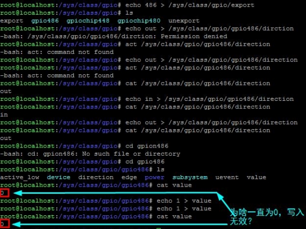

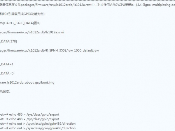

按照以下方法复用JTAG,为啥value无法写入1?

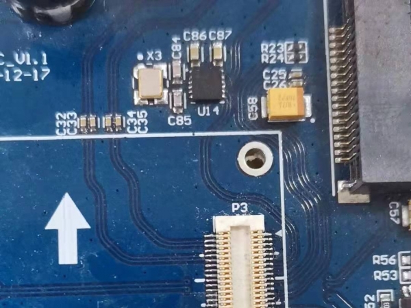

1012参考手册中关于JTAG引脚复用中有说明
注意:This field is ignored if TJTAG_EN=1, in which case these pins are used as JTAG.
需要在硬件上拉低,如下图所示:
