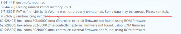

问题1、再替换了logo之后分别进行全编译测试和单独编译内核,替换的logo出不来且SD卡启动后都会卡在
[    4.806195] random: crng init done
[   62.541463] imx-sdma 302b0000.dma-controller: external firmware not found, using ROM firmware
[   62.541560] imx-sdma 30bd0000.dma-controller: external firmware not found, using ROM firmware
[   62.541962] imx-sdma 302c0000.dma-controller: external firmware not found, using ROM firmware

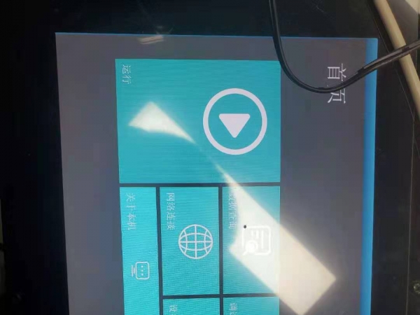

问题2、按照文档设置qt自启动程序失败
问题3、通过命令行启动自己编译的qt程序,但是会有缩小关闭的状态栏
报错

3、按照说明书设置的开机自启程序,但是不成功,然后在命令行./MyDemo程序,可以运行,但是会有状态栏,如图所示

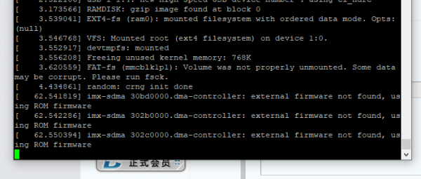

您好,这次我什么都没有更改,按照说明说进行了整体编译之后tf卡启动 但是还是会报错,错误以及log信息如下: U-Boot SPL 2018.03-dirty (Feb 25 2020 - 02:38:23 +0000) power_bd71837_init DRAM PHY training f  详情 回复 发表于 2021-4-7 11:08

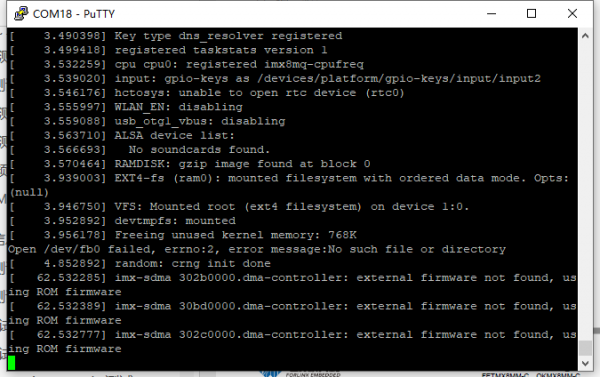

power_bd71837_init
DRAM PHY training for 2400MTS
check ddr4_pmu_train_imem code
check ddr4_pmu_train_imem code pass
check ddr4_pmu_train_dmem code
check ddr4_pmu_train_dmem code pass
Training PASS
DRAM PHY training for 400MTS
Training PASS
DRAM PHY training for 100MTS
Training PASS
Training PASS
DS2460 OK
Normal Boot
Trying to boot from MMC1
U-Boot 2018.03-dirty (Feb 25 2020 - 02:38:23 +0000)
CPU:   Freescale i.MX8MMQ rev1.0 1800 MHz (running at 1200 MHz)
CPU:   Commercial temperature grade (0C to 95C) at 29C
Reset cause: POR
Model: FSL i.MX8MM EVK board
DRAM:  2 GiB
MMC:   FSL_SDHC: 0, FSL_SDHC: 1
Loading Environment from MMC... *** Warning - bad CRC, using default environment
OK
Display: MIPI7 (1024x600)
Video: 1024x600x24
** Unable to read file logo.bmp **
Logo:
There is no valid bmp file at the given address
Error: no valid bmp image at 40480000
In:    serial
Out:   serial
Err:   serial
BuildInfo:
  - ATF d6451cc
  - U-Boot 2018.03-dirty
switch to partitions #0, OK
mmc0 is current device
flash target is MMC:0
Net:
Warning: ethernet@30be0000 (eth0) using random MAC address - 46:36:cc:32:d9:40
Saving Environment to MMC... Writing to MMC(0)... OK
eth0: ethernet@30be0000
Fastboot: Normal
Normal Boot

djh
[attachimg]11506[/attachimg] 您的TF卡没有挂载上,建议您重新制一下卡, 附件中有我用TF烧写时的打印信息,你那边有屏幕吗? 烧写进度请留意 LCD 上的打印信息  详情 回复 发表于 2021-4-7 11:55
发表于 2021-4-7 11:55:14 | 显示全部楼层
Jamz_T 发表于 2021-4-7 11:08
您好,这次我什么都没有更改,按照说明说进行了整体编译之后tf卡启动 但是还是会报错,错误以及log信息如 ...
烧写进度请留意 LCD 上的打印信息
8MM+TF卡烧写.zip

[    3.718430] FAT-fs (mmcblk1p1): Volume was not properly unmounted. Some data may be corrupt. Please run fsck.
[    5.281592] random: crng init done
[   62.527760] imx-sdma 302b0000.dma-controller: external firmware not found, using ROM firmware
[   62.527763] imx-sdma 302c0000.dma-controller: external firmware not found, using ROM firmware
[   62.527887] imx-sdma 30bd0000.dma-controller: external firmware not found, using ROM firmware
卡在这里,长时间没有log输出
请问从log看可以认为是烧写已完成,但没有启动成功吗?
