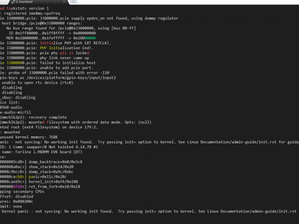

按照教程,配置好uuu,拨码开关设置好,内核启动到一半出现 end Kernel panic错误,下面的日志如下,请问这是啥问题导致的? linux3.png linux2.png linux1.png

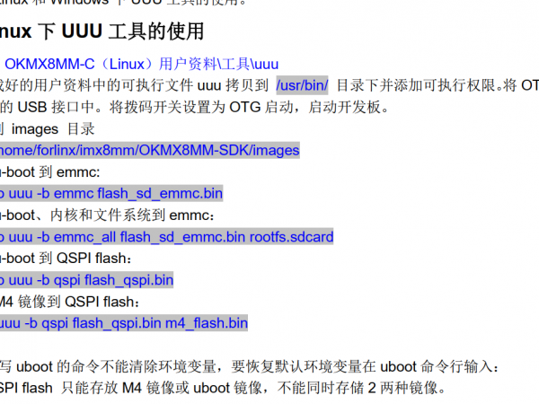

应该是没烧写成功 您用UUU烧写执行了哪些指令啊?能发一下串口打印信息吗? 您尝试过用TF卡烧写吗?  详情 回复 发表于 2021-5-17 09:12
您尝试过用TF卡烧写吗?
下面是uuu设置的步骤: alban@alban-pc:~/linux/atk-mp1/linux-5.4.31-g265df13e0-v1.0$ cd alban@alban-pc:~$ cd linux/imx8mm/ alban@alban-pc:~/linux/imx8mm$ ls images linux-imx tool toolChain uboot  详情 回复 发表于 2021-5-17 19:29
也试过SD卡也不行  详情 回复 发表于 2021-5-17 18:57

也试过SD卡也不行,下面是启动日志:

Starting kernel ...
[    0.000000] Linux version 4.14.78 (lixinguo@a1591b2bde08) (gcc version 7.3.0 (GCC)) #1 SMP PREEMPT Tue Feb 25 03:59:49 UTC 2020

[    0.495270] bd71837 0-004b: chip_irq=73
[    0.507414] bd71837-pmic bd71837-pmic: regulator register name 'buck1'
[    0.527578] bd71837-pmic bd71837-pmic: regulator register name 'buck2'
[    0.547592] bd71837-pmic bd71837-pmic: regulator register name 'buck3'
[    0.559643] bd71837-pmic bd71837-pmic: regulator register name 'buck4'
[    0.571636] bd71837-pmic bd71837-pmic: regulator register name 'buck5'
[    0.583672] bd71837-pmic bd71837-pmic: regulator register name 'buck6'
[    0.595697] bd71837-pmic bd71837-pmic: regulator register name 'buck7'
[    0.607728] bd71837-pmic bd71837-pmic: regulator register name 'buck8'
[    0.619750] bd71837-pmic bd71837-pmic: regulator register name 'ldo1'
[    0.639799] bd71837-pmic bd71837-pmic: regulator register name 'ldo2'
[    0.647813] bd71837-pmic bd71837-pmic: regulator register name 'ldo3'
[    0.667853] bd71837-pmic bd71837-pmic: regulator register name 'ldo4'
[    0.687903] bd71837-pmic bd71837-pmic: regulator register name 'ldo5'
[    0.695916] bd71837-pmic bd71837-pmic: regulator register name 'ldo6'
[    0.715958] bd71837-pmic bd71837-pmic: regulator register name 'ldo7'
[    0.736019] i2c i2c-0: IMX I2C adapter registered
[    0.737879] i2c i2c-0: can't use DMA, using PIO instead.
[    0.744069] i2c i2c-1: IMX I2C adapter registered
[    0.747979] i2c i2c-1: can't use DMA, using PIO instead.
[    0.753399] BD71837:bd71837_pmic_interrupt() in.
[    0.753851] i2c i2c-2: IMX I2C adapter registered
[    0.753858] i2c i2c-2: can't use DMA, using PIO instead.
[    0.754480] i2c i2c-3: IMX I2C adapter registered
[    0.754487] i2c i2c-3: can't use DMA, using PIO instead.
[    0.754934] media: Linux media inte**ce: v0.10
[    0.754984] Linux video capture inte**ce: v2.00
[    0.755100] pps_core: LinuxPPS API ver. 1 registered
[    0.755105] pps_core: Software ver. 5.3.6 - Copyright 2005-2007 Rodolfo Giometti <giometti@linux.it>
[    0.755123] PTP clock support registered
[    0.755335] EDAC MC: Ver: 3.0.0
[    0.755698] dmi: Firmware registration failed.
[    0.756654] MU is ready for cross core communication!
[    0.819770] virtio_rpmsg_bus virtio0: rpmsg host is online
[    0.822260] BD71837:IRQ_WDOG
[    0.822262] BD71837:IRQ_ON_REQ
[    0.829981] imx rpmsg driver is registered.
[    0.833916] Advanced Linux Sound Architecture Driver Initialized.
[    0.840533] Bluetooth: Core ver 2.22
[    0.843430] NET: Registered protocol family 31
[    0.847875] Bluetooth: HCI device and connection manager initialized
[    0.854269] Bluetooth: HCI socket layer initialized
[    0.859159] Bluetooth: L2CAP socket layer initialized
[    0.864253] Bluetooth: SCO socket layer initialized
[    0.869940] clocksource: Switched to clocksource arch_sys_counter
[    0.875433] VFS: Disk quotas dquot_6.6.0
[    0.879246] VFS: Dquot-cache hash table entries: 512 (order 0, 4096 bytes)
[    0.886246] pnp: PnP ACPI: disabled
[    0.895295] NET: Registered protocol family 2
[    0.897356] TCP established hash table entries: 16384 (order: 5, 131072 bytes)
[    0.904252] TCP bind hash table entries: 16384 (order: 6, 262144 bytes)
[    0.911083] TCP: Hash tables configured (established 16384 bind 16384)
[    0.917680] UDP hash table entries: 1024 (order: 3, 32768 bytes)
[    0.923377] UDP-Lite hash table entries: 1024 (order: 3, 32768 bytes)
[    0.930051] NET: Registered protocol family 1
[    0.934705] RPC: Registered named UNIX socket transport module.
[    0.940139] RPC: Registered udp transport module.
[    0.944860] RPC: Registered tcp transport module.
[    0.949583] RPC: Registered tcp NFSv4.1 backchannel transport module.
[    0.957169] hw perfevents: enabled with armv8_pmuv3 PMU driver, 7 counters available
[    0.964271] kvm [1]: 8-bit VMID
[    0.967804] kvm [1]: GICv3: no GICV resource entry
[    0.971811] kvm [1]: disabling GICv2 emulation
[    0.976297] kvm [1]: GIC system register CPU inte**ce enabled
[    0.982203] kvm [1]: vgic interrupt IRQ1
[    0.986162] kvm [1]: Hyp mode initialized successfully
[    0.993755] audit: initializing netlink subsys (disabled)
[    0.996771] audit: type=2000 audit(0.892:1): state=initialized audit_enabled=0 res=1
[    0.997163] workingset: timestamp_bits=44 max_order=19 bucket_order=0
[    1.003046] squashfs: version 4.0 (2009/01/31) Phillip Lougher
[    1.003643] NFS: Registering the id_resolver key type
[    1.003672] Key type id_resolver registered
[    1.003676] Key type id_legacy registered
[    1.003687] nfs4filelayout_init: NFSv4 File Layout Driver Registering...
[    1.003712] jffs2: version 2.2. (NAND) &#169; 2001-2006 Red Hat, Inc.
[    1.004227] 9p: Installing v9fs 9p2000 file system support
[    1.008904] Block layer SCSI generic (bsg) driver version 0.4 loaded (major 245)
[    1.008913] io scheduler noop registered
[    1.009076] io scheduler cfq registered (default)
[    1.009081] io scheduler mq-deadline registered
[    1.009085] io scheduler kyber registered
[    1.016076] pwm-backlight backlight@0: backlight@0 supply power not found, using dummy regulator
[    1.019133] imx-sdma 30bd0000.dma-controller: no iram assigned, using external mem
[    1.025532] imx-sdma 30bd0000.dma-controller: Falling back to user helper
[    1.027228] imx-sdma 302c0000.dma-controller: no iram assigned, using external mem
[    1.036490] imx-sdma 302b0000.dma-controller: no iram assigned, using external mem
[    1.044525] mxs-dma 33000000.dma-apbh: initialized
[    1.046364] Bus freq driver module loaded
[    1.050973] Serial: 8250/16550 driver, 4 ports, IRQ sharing enabled
[    1.054131] 30860000.serial: ttymxc0 at MMIO 0x30860000 (irq = 27, base_baud = 5000000) is a IMX
[    1.055499] 30880000.serial: ttymxc2 at MMIO 0x30880000 (irq = 28, base_baud = 5000000) is a IMX
[    1.056302] 30890000.serial: ttymxc1 at MMIO 0x30890000 (irq = 29, base_baud = 1500000) is a IMX
[    1.156311] console [ttymxc1] enabled
[    1.160780] bootconsole [ec_imx6q0] disabled
[    1.177233] [drm] Supports vblank timestamp caching Rev 2 (21.10.2013).
[    1.183892] [drm] No driver support for vblank timestamp query.
[    1.189960] imx-drm display-subsystem: bound imx-lcdif-crtc.0 (ops lcdif_crtc_ops)
[    1.197694] imx_sec_dsim_drv 32e10000.mipi_dsi: version number is 0x1060200
[    1.204879] panel-**-dsi 32e10000.mipi_dsi.0: 32e10000.mipi_dsi.0 supply power not found, using dummy regulator
[    1.215469] imx-drm display-subsystem: bound 32e10000.mipi_dsi (ops imx_sec_dsim_ops)
[    1.226249] imx-drm display-subsystem: fb0:  frame buffer device
[    1.232635] [drm] Initialized imx-drm 1.0.0 20120507 for display-subsystem on minor 0
[    1.248109] brd: module loaded
[    1.256368] loop: module loaded
[    1.263238] random: fast init done
[    1.271911] fsl-flexspi 30bb0000.flexspi: w25q128 (16384 Kbytes)
[    1.278989] slram: not enough parameters.
[    1.285045] spi_imx 30820000.ecspi: probed
[    1.290031] spi_imx 30830000.ecspi: probed
[    1.295281] libphy: Fixed MDIO Bus: probed
[    1.299721] NXP PHY: loading NXP PHY driver: [autonomous mode]
[    1.305755] tun: Universal TUN/TAP device driver, 1.6
[    1.311057] CAN device driver inte**ce
[    1.325250] mcp251x spi1.0: Cannot initialize MCP2515. Wrong wiring?
[    1.331628] mcp251x spi1.0: Probe failed, err=19
[    1.338230] fec 30be0000.ethernet: 30be0000.ethernet supply phy not found, using dummy regulator
[    1.347398] pps pps0: new PPS source ptp0
[    1.357561] libphy: fec_enet_mii_bus: probed
[    1.362833] fec 30be0000.ethernet eth0: registered PHC device 0
[    1.369604] e1000e: Intel(R) PRO/1000 Network Driver - 3.2.6-k
[    1.375464] e1000e: Copyright(c) 1999 - 2015 Intel Corporation.
[    1.381446] igb: Intel(R) Gigabit Ethernet Network Driver - version 5.4.0-k
[    1.388423] igb: Copyright (c) 2007-2014 Intel Corporation.
[    1.394039] igbvf: Intel(R) Gigabit Virtual Function Network Driver - version 2.4.0-k
[    1.401882] igbvf: Copyright (c) 2009 - 2012 Intel Corporation.
[    1.408009] sky2: driver version 1.30
[    1.413436] ehci_hcd: USB 2.0 'Enhanced' Host Controller (EHCI) Driver
[    1.419993] ehci-pci: EHCI PCI platform driver
[    1.424503] ehci-platform: EHCI generic platform driver
[    1.429942] ohci_hcd: USB 1.1 'Open' Host Controller (OHCI) Driver
[    1.436153] ohci-pci: OHCI PCI platform driver
[    1.440667] ohci-platform: OHCI generic platform driver
[    1.446516] usbcore: registered new inte**ce driver usb-storage
[    1.452578] usbcore: registered new inte**ce driver usb_ehset_test
[    1.460010] usbmisc_imx 32e40200.usbmisc: 32e40200.usbmisc supply vbus-wakeup not found, using dummy regulator
[    1.470461] usbmisc_imx 32e50200.usbmisc: 32e50200.usbmisc supply vbus-wakeup not found, using dummy regulator
[    1.487626] imx_usb 32e50000.usb: 32e50000.usb supply vbus not found, using dummy regulator
[    1.498985] ci_hdrc ci_hdrc.1: EHCI Host Controller
[    1.503901] ci_hdrc ci_hdrc.1: new USB bus registered, assigned bus number 1
[    1.525998] ci_hdrc ci_hdrc.1: USB 2.0 started, EHCI 1.00
[    1.532270] hub 1-0:1.0: USB hub found
[    1.536070] hub 1-0:1.0: 1 port detected
[    1.541970] input: InputEmulator as /devices/virtual/input/input0
[    1.548763] <<-GTP-INFO->> GTP driver installing...
[    1.554298] i2c /dev entries driver
[    1.559696] mxc_mipi-csi 32e30000.mipi_csi: 32e30000.mipi_csi supply mipi-phy not found, using dummy regulator
[    1.570160] mxc_mipi-csi 32e30000.mipi_csi: mipi csi v4l2 device registered
[    1.577140] CSI: Registered sensor subdevice: mxc_mipi-csi.0
[    1.582834] mxc_mipi-csi 32e30000.mipi_csi: lanes: 2, hs_settle: 13, clk_settle: 2, wclk: 1, freq: 333000000
[    1.593202] ov5640_mipi 3-003c: 3-003c supply DOVDD not found, using dummy regulator
[    1.601023] ov5640_mipi 3-003c: 3-003c supply DVDD not found, using dummy regulator
[    1.608720] ov5640_mipi 3-003c: 3-003c supply AVDD not found, using dummy regulator
[    1.686264] ov5640_mipi 3-003c: Read reg error: reg=300a
[    1.691589] ov5640_mipi 3-003c: Camera is not found
[    1.711299] imx2-wdt 30280000.wdog: timeout 60 sec (nowayout=0)
[    1.718603] sdhci: Secure Digital Host Controller Inte**ce driver
[    1.724814] sdhci: Copyright(c) Pierre Ossman
[    1.729305] Synopsys Designware ** Card Inte**ce Driver
[    1.735847] sdhci-pltfm: SDHCI platform and OF driver helper
[    1.789998] mmc0: SDHCI controller on 30b40000.mmc [30b40000.mmc] using ADMA
[    1.801448] sdhci-esdhc-imx 30b50000.mmc: Got CD GPIO
[    1.859627] mmc1: SDHCI controller on 30b50000.mmc [30b50000.mmc] using ADMA
[    1.873988] usb 1-1: new high-speed USB device number 2 using ci_hdrc
[    1.914045] mmc2: SDHCI controller on 30b60000.mmc [30b60000.mmc] using ADMA
[    1.928007] galcore: clk_get vg clock failed, disable vg!
[    1.933665] Galcore version 6.2.4.163672
[    2.020166] mmc2: new HS200 MMC card at address 0001
[    2.025962] mmcblk2: mmc2:0001 DG4008 7.28 GiB
[    2.028182] hantrodec 0 : module inserted. Major = 240
[    2.029144] hantrodec 1 : module inserted. Major = 240
[    2.030462] hx280enc: module inserted. Major <239>
[    2.035710] ledtrig-cpu: registered to indicate activity on CPUs
[    2.036418] caam 30900000.caam: ERA source: CCBVID.
[    2.039110] hub 1-1:1.0: USB hub found
[    2.039219] hub 1-1:1.0: 4 ports detected
[    2.039253] caam 30900000.caam: device ID = 0x0a16040100000000 (Era 9)
[    2.039258] caam 30900000.caam: job rings = 3, qi = 0, dpaa2 = no
[    2.077571] mmcblk2boot0: mmc2:0001 DG4008 partition 1 4.00 MiB
[    2.083946] mmcblk2boot1: mmc2:0001 DG4008 partition 2 4.00 MiB
[    2.090355] mmcblk2rpmb: mmc2:0001 DG4008 partition 3 4.00 MiB
[    2.101931] caam_jr 30901000.jr0: Entropy delay = 3200
[    2.107734]  mmcblk2: p1 p2
[    2.107835] caam_jr 30901000.jr0: Entropy delay = 3600
[    2.176064] caam_jr 30901000.jr0: Instantiated RNG4 SH0.
[    2.243356] caam_jr 30901000.jr0: Instantiated RNG4 SH1.
[    2.265046] caam algorithms registered in /proc/crypto
[    2.273667] caam_jr 30901000.jr0: registering rng-caam
[    2.279147] caam 30900000.caam: caam pkc algorithms registered in /proc/crypto
[    2.287817] platform caam_sm: blkkey_ex: 2 keystore units available
[    2.294227] platform caam_sm: 64-bit clear key:
[    2.298783] platform caam_sm: [0000] 00 01 02 03 04 0f 06 07
[    2.304466] platform caam_sm: 64-bit black key:
[    2.309013] platform caam_sm: [0000] f9 ea 7a 71 0a 1c a4 e8
[    2.314684] platform caam_sm: [0008] 5a e5 ae f0 40 aa 36 a0
[    2.320357] platform caam_sm: 128-bit clear key:
[    2.324986] platform caam_sm: [0000] 00 01 02 03 04 0f 06 07
[    2.329957] usb 1-1.4: new high-speed USB device number 3 using ci_hdrc
[    2.337337] platform caam_sm: [0008] 08 09 0a 0b 0c 0d 0e 0f
[    2.343012] platform caam_sm: 128-bit black key:
[    2.347655] platform caam_sm: [0000] 22 0e 69 4e 56 3a 6c 66
[    2.353326] platform caam_sm: [0008] e7 c6 84 bf e2 75 2f 61
[    2.359013] platform caam_sm: 192-bit clear key:
[    2.363673] platform caam_sm: [0000] 00 01 02 03 04 0f 06 07
[    2.369346] platform caam_sm: [0008] 08 09 0a 0b 0c 0d 0e 0f
[    2.375018] platform caam_sm: [0016] 10 11 12 13 14 15 16 17
[    2.380688] platform caam_sm: 192-bit black key:
[    2.385328] platform caam_sm: [0000] 4f 82 4e 07 04 8b 02 ad
[    2.390999] platform caam_sm: [0008] 9d f2 28 38 07 1d 39 b0

[    3.904255] Kernel panic - not syncing: No working init found.  Try passing init= option to kernel. See Linux Documentation/admin-guide/init.rst for guidance.
[    3.918426] CPU: 1 PID: 1 Comm: swapper/0 Not tainted 4.14.78 #1
[    3.924429] Hardware name: Forlinx i.MX8MM EVK board (DT)
[    3.929825] Call trace:
[    3.932281] [<ffff000008089cd0>] dump_backtrace+0x0/0x3c8
[    3.937679] [<ffff00000808a0ac>] show_stack+0x14/0x20
[    3.942733] [<ffff000008c9bcc0>] dump_stack+0x9c/0xbc
[    3.947784] [<ffff0000080cecb8>] panic+0x11c/0x28c
[    3.952574] [<ffff000008cae69c>] kernel_init+0xf4/0x108
[    3.957798] [<ffff000008084f60>] ret_from_fork+0x10/0x18
[    3.963112] SMP: stopping secondary CPUs
[    3.967563] Kernel Offset: disabled
[    3.971051] CPU features: 0x080200c
[    3.974537] Memory Limit: none
[    3.977594] ---[ end Kernel panic - not syncing: No working init found.  Try passing init= option to kernel. See Linux Documentation/admin-guide/init.rst for guidance.

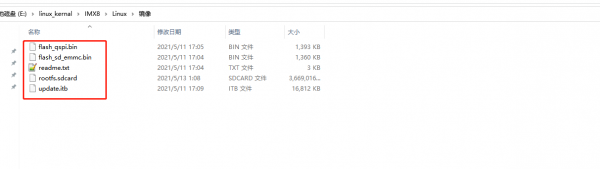

images  linux-imx  tool  toolChain  uboot-imx
alban@alban-pc:~/linux/imx8mm$ cd images/
alban@alban-pc:~/linux/imx8mm/images$ ls
flash_qspi.bin  flash_sd_emmc.bin  readme.txt  rootfs.sdcard  update.itb
alban@alban-pc:~/linux/imx8mm/images$ sudo uuu -b emmc flash_sd_emmc.bin
[sudo] password for alban:
uuu (Universal Update Utility) for nxp imx chips -- libuuu_1.2.91-0-g3799f4d
Success 1    Failure 0
3:2    3/ 3   [============100%============] SDPU: jump
alban@alban-pc:~/linux/imx8mm/images$      ] FB: Done
alban@alban-pc:~/linux/imx8mm/images$  sudo uuu -b emmc_all flash_sd_emmc.bin rootfs.sdcard
Success 1    Failure 0
3:41   8/ 8   [Done                        ] FB: done
alban@alban-pc:~/linux/imx8mm/images$ sudo uuu -b qspi flash_qspi.bin
Success 1    Failure 0
3:41   6/ 6   [Done                        ] FB: done
