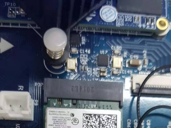

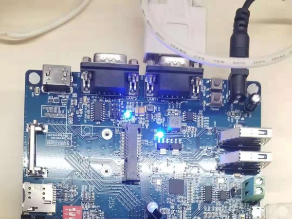

开发板:OKMX8MX-C V1.1WIFI模块:3168NGW
固件:官方固件 Linux imx8mqevk 5.4.3 #1 SMP PREEMPT Tue Oct 27 08:18:23 UTC 2020 aarch64 aarch64 aarch64 GNU/Linux
现象:wifi驱动加载失败

  499. [  130.089575] Bluetooth: hci0: failed to open default fw file: intel/ibt-hw-37.8.bseq
  500. [  189.481151] iwlwifi 0000:01:00.0: Direct firmware load for iwlwifi-3168-26.ucode failed with error -2
  501. [  189.490443] iwlwifi 0000:01:00.0: Falling back to sysfs fallback for: iwlwifi-3168-26.ucode
  502. [  250.921187] iwlwifi 0000:01:00.0: Direct firmware load for iwlwifi-3168-25.ucode failed with error -2
  503. [  250.930474] iwlwifi 0000:01:00.0: Falling back to sysfs fallback for: iwlwifi-3168-25.ucode
  504. [  312.361162] iwlwifi 0000:01:00.0: Direct firmware load for iwlwifi-3168-24.ucode failed with error -2
  505. [  312.370450] iwlwifi 0000:01:00.0: Falling back to sysfs fallback for: iwlwifi-3168-24.ucode
  506. [  373.801168] iwlwifi 0000:01:00.0: Direct firmware load for iwlwifi-3168-23.ucode failed with error -2
  507. [  373.810448] iwlwifi 0000:01:00.0: Falling back to sysfs fallback for: iwlwifi-3168-23.ucode
  508. [  435.241169] iwlwifi 0000:01:00.0: Direct firmware load for iwlwifi-3168-22.ucode failed with error -2
  509. [  435.250458] iwlwifi 0000:01:00.0: Falling back to sysfs fallback for: iwlwifi-3168-22.ucode
  510. [  496.680577] iwlwifi 0000:01:00.0: no suitable firmware found!
  511. [  496.686383] iwlwifi 0000:01:00.0: minimum version required: iwlwifi-3168-22
  512. [  496.693418] iwlwifi 0000:01:00.0: maximum version supported: iwlwifi-3168-29
  513. [  496.700502] iwlwifi 0000:01:00.0: check git://git.kernel.org/pub/scm/linux/kernel/git/firmware/linux-firmware.git
复制代码
