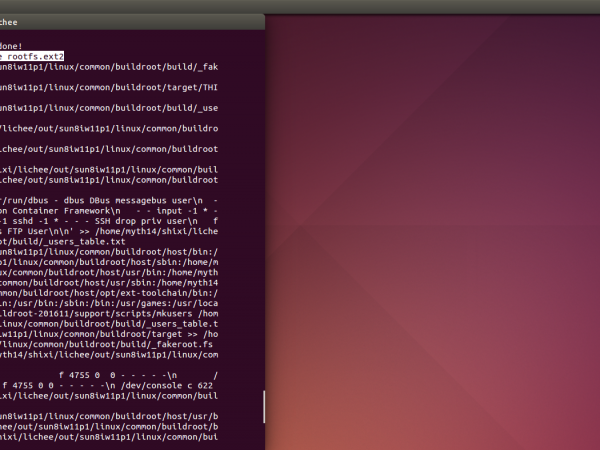

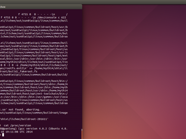

按照A40i-linuxSDK手册进行自动编译时出现了一个报错

您这是哪找的手册啊,我们提供的手册有编译方法,在用户手册第四章,您用我们提供的方法编译

就是按照用户手册第四章编译的

您编译的时候执行了哪些命令,能把执行的命令发过来看一下嘛,全部的命令,我这边看一下您怎么执行的

cd lichee
./build.sh config
./build.sh   //在执行这一步命令时出去。
发表于 2021-6-24 11:35:45 | 显示全部楼层
您把源码路径设成和手册上一致再试试呢

试过了,还是不行

  1. >>>   Generating root filesystem image rootfs.ext2
  2. rm -f /root/lichee/out/sun8iw11p1/linux/common/buildroot/build/_fakeroot.fs
  3. rm -f /root/lichee/out/sun8iw11p1/linux/common/buildroot/target/THIS_IS_NOT_YOUR_ROOT_FILESYSTEM
  4. rm -f /root/lichee/out/sun8iw11p1/linux/common/buildroot/build/_users_table.txt
  5. echo '#!/bin/sh' > /root/lichee/out/sun8iw11p1/linux/common/buildroot/build/_fakeroot.fs
  6. echo "set -e" >> /root/lichee/out/sun8iw11p1/linux/common/buildroot/build/_fakeroot.fs
  7. echo "chown -h -R 0:0 /root/lichee/out/sun8iw11p1/linux/common/buildroot/target" >> /root/lichee/out/sun8iw11p1/linux/common/buildroot/build/_fakeroot.fs
  8. printf '           dbus -1 dbus -1 * /var/run/dbus - dbus DBus messagebus user\n         - - docker -1 * - - - Docker Application Container Framework\n         - - input -1 * - - - Input device group\n         sshd -1 sshd -1 * - - - SSH drop priv user\n         ftp -1 ftp -1 * /home/ftp - - Anonymous FTP User\n\n' >> /root/lichee/out/sun8iw11p1/linux/common/buildroot/build/_users_table.txt
  9. PATH="/root/lichee/out/sun8iw11p1/linux/common/buildroot/host/bin:/root/lichee/out/sun8iw11p1/linux/common/buildroot/host/sbin:/root/lichee/out/sun8iw11p1/linux/common/buildroot/host/usr/bin:/root/lichee/out/sun8iw11p1/linux/common/buildroot/host/usr/sbin:/root/lichee/out/sun8iw11p1/linux/common/buildroot/host/opt/ext-toolchain/bin:/usr/local/sbin:/usr/local/bin:/usr/sbin:/usr/bin:/sbin:/bin:/usr/games:/usr/local/games" /root/lichee/buildroot-201611/support/scripts/mkusers /root/lichee/out/sun8iw11p1/linux/common/buildroot/build/_users_table.txt /root/lichee/out/sun8iw11p1/linux/common/buildroot/target >> /root/lichee/out/sun8iw11p1/linux/common/buildroot/build/_fakeroot.fs
  10. cat system/device_table.txt > /root/lichee/out/sun8iw11p1/linux/common/buildroot/build/_device_table.txt
  11. printf '           /bin/busybox                     f 4755 0  0 - - - - -\n         /usr/libexec/dbus-daemon-launch-helper f 4755 0 0 - - - - -\n /dev/console c 622 0 0 5 1 - - -\n\n' >> /root/lichee/out/sun8iw11p1/linux/common/buildroot/build/_device_table.txt
  12. echo "/root/lichee/out/sun8iw11p1/linux/common/buildroot/host/usr/bin/makedevs -d /root/lichee/out/sun8iw11p1/linux/common/buildroot/build/_device_table.txt /root/lichee/out/sun8iw11p1/linux/common/buildroot/target" >> /root/lichee/out/sun8iw11p1/linux/common/buildroot/build/_fakeroot.fs
  13. printf '           PATH="/root/lichee/out/sun8iw11p1/linux/common/buildroot/host/bin:/root/lichee/out/sun8iw11p1/linux/common/buildroot/host/sbin:/root/lichee/out/sun8iw11p1/linux/common/buildroot/host/usr/bin:/root/lichee/out/sun8iw11p1/linux/common/buildroot/host/usr/sbin:/root/lichee/out/sun8iw11p1/linux/common/buildroot/host/opt/ext-toolchain/bin:/usr/local/sbin:/usr/local/bin:/usr/sbin:/usr/bin:/sbin:/bin:/usr/games:/usr/local/games" mke2img -d /root/lichee/out/sun8iw11p1/linux/common/buildroot/target -G 4 -R 1 -B 0 -I 0 -o /root/lichee/out/sun8iw11p1/linux/common/buildroot/images/rootfs.ext2\n' >> /root/lichee/out/sun8iw11p1/linux/common/buildroot/build/_fakeroot.fs
  14. chmod a+x /root/lichee/out/sun8iw11p1/linux/common/buildroot/build/_fakeroot.fs
  15. PATH="/root/lichee/out/sun8iw11p1/linux/common/buildroot/host/bin:/root/lichee/out/sun8iw11p1/linux/common/buildroot/host/sbin:/root/lichee/out/sun8iw11p1/linux/common/buildroot/host/usr/bin:/root/lichee/out/sun8iw11p1/linux/common/buildroot/host/usr/sbin:/root/lichee/out/sun8iw11p1/linux/common/buildroot/host/opt/ext-toolchain/bin:/usr/local/sbin:/usr/local/bin:/usr/sbin:/usr/bin:/sbin:/bin:/usr/games:/usr/local/games" /root/lichee/out/sun8iw11p1/linux/common/buildroot/host/usr/bin/fakeroot -- /root/lichee/out/sun8iw11p1/linux/common/buildroot/build/_fakeroot.fs
  16. fakeroot: preload library `libfakeroot.so' not found, aborting.
  17. make: *** [/root/lichee/out/sun8iw11p1/linux/common/buildroot/images/rootfs.ext2] Error 1
  18. make: Leaving directory `/root/lichee/buildroot-201611'
  19. ERROR: build rootfs Failed

源码路径/root/workspace/allwinner/A40i/bsp/lichee

处理好了,爱你:kiss:
