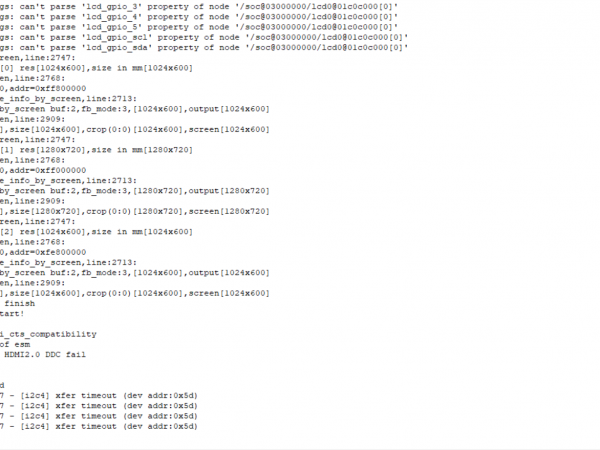

启动时报以下错误,不能进冒号.是不是要关闭某个驱动sunxi_i2c_do_xfer()1947 - [i2c4] xfer timeout (dev addr:0x5d)

您方便把您启机的打印信息发过来吗?我给您看一下。

 楼主| 发表于 2022-4-11 16:51:15 | 显示全部楼层
打印信息已更新

您现在烧录的是用户资料里边的镜像还是您编译打包生成的镜像?从打印信息来看,您现在接的是hdmi屏做显示吗?您在uboot阶段有选屏吗?
烧写的是自己修改过的镜像,不过只修改了串口和SPI的配置.
我是不接屏使用.
还有,这块核心板是返修板,加密芯片已根据后面升级的版本升了级的,下载的是最新的镜像.不知道跟这个有没有关系.
其他几块核心板同样的镜像,没有这个问题.
刚才试了一个超时久才启动:

[   10.428530] sunxi_i2c_do_xfer()1947 - [i2c4] xfer timeout (dev addr:0x5d)
[   15.548529] sunxi_i2c_do_xfer()1947 - [i2c4] xfer timeout (dev addr:0x5d)
[   20.668541] sunxi_i2c_do_xfer()1947 - [i2c4] xfer timeout (dev addr:0x5d)
[   25.788532] sunxi_i2c_do_xfer()1947 - [i2c4] xfer timeout (dev addr:0x5d)
[   30.908541] sunxi_i2c_do_xfer()1947 - [i2c4] xfer timeout (dev addr:0x5d)
[   30.916221] <<-GTP-ERROR->> I2C Write: 0x8041, 1 bytes failed, errcode: -62!
[   36.028535] sunxi_i2c_do_xfer()1947 - [i2c4] xfer timeout (dev addr:0x5d)
[   41.148533] sunxi_i2c_do_xfer()1947 - [i2c4] xfer timeout (dev addr:0x5d)
[   46.268554] sunxi_i2c_do_xfer()1947 - [i2c4] xfer timeout (dev addr:0x5d)
[   51.388540] sunxi_i2c_do_xfer()1947 - [i2c4] xfer timeout (dev addr:0x5d)
[   56.511856] sunxi_i2c_do_xfer()1947 - [i2c4] xfer timeout (dev addr:0x5d)
[   56.519544] <<-GTP-ERROR->> I2C Read: 0x8047, 1 bytes failed, errcode: -62! Process reset.
[   56.528869] <<-GTP-INFO->> Guitar reset
[   61.841860] sunxi_i2c_do_xfer()1947 - [i2c4] xfer timeout (dev addr:0x5d)
[   66.965198] sunxi_i2c_do_xfer()1947 - [i2c4] xfer timeout (dev addr:0x5d)
[   72.081863] sunxi_i2c_do_xfer()1947 - [i2c4] xfer timeout (dev addr:0x5d)
[   77.201854] sunxi_i2c_do_xfer()1947 - [i2c4] xfer timeout (dev addr:0x5d)
[   82.321861] sunxi_i2c_do_xfer()1947 - [i2c4] xfer timeout (dev addr:0x5d)
[   82.329537] <<-GTP-ERROR->> I2C Write: 0x8041, 1 bytes failed, errcode: -62!
[   82.337505] <<-GTP-ERROR->> GTP i2c test failed time 1.
[   87.441856] sunxi_i2c_do_xfer()1947 - [i2c4] xfer timeout (dev addr:0x5d)
[   92.561848] sunxi_i2c_do_xfer()1947 - [i2c4] xfer timeout (dev addr:0x5d)
[   97.681849] sunxi_i2c_do_xfer()1947 - [i2c4] xfer timeout (dev addr:0x5d)
[  102.801851] sunxi_i2c_do_xfer()1947 - [i2c4] xfer timeout (dev addr:0x5d)
[  107.419429] random: crng init done
[  107.921850] sunxi_i2c_do_xfer()1947 - [i2c4] xfer timeout (dev addr:0x5d)
[  107.929546] <<-GTP-ERROR->> I2C Read: 0x8047, 1 bytes failed, errcode: -62! Process reset.
[  107.938875] <<-GTP-INFO->> Guitar reset
[  113.041855] sunxi_i2c_do_xfer()1947 - [i2c4] xfer timeout (dev addr:0x5d)
[  118.161857] sunxi_i2c_do_xfer()1947 - [i2c4] xfer timeout (dev addr:0x5d)
[  123.281853] sunxi_i2c_do_xfer()1947 - [i2c4] xfer timeout (dev addr:0x5d)
[  128.401849] sunxi_i2c_do_xfer()1947 - [i2c4] xfer timeout (dev addr:0x5d)
[  133.521848] sunxi_i2c_do_xfer()1947 - [i2c4] xfer timeout (dev addr:0x5d)
[  133.529528] <<-GTP-ERROR->> I2C Write: 0x8041, 1 bytes failed, errcode: -62!
[  133.537527] <<-GTP-ERROR->> GTP i2c test failed time 2.
[  138.641848] sunxi_i2c_do_xfer()1947 - [i2c4] xfer timeout (dev addr:0x5d)
[  143.761850] sunxi_i2c_do_xfer()1947 - [i2c4] xfer timeout (dev addr:0x5d)
[  148.881836] sunxi_i2c_do_xfer()1947 - [i2c4] xfer timeout (dev addr:0x5d)
[  154.001842] sunxi_i2c_do_xfer()1947 - [i2c4] xfer timeout (dev addr:0x5d)
[  159.121840] sunxi_i2c_do_xfer()1947 - [i2c4] xfer timeout (dev addr:0x5d)
[  159.129525] <<-GTP-ERROR->> I2C Read: 0x8047, 1 bytes failed, errcode: -62! Process reset.
[  159.138879] <<-GTP-INFO->> Guitar reset
[  164.241838] sunxi_i2c_do_xfer()1947 - [i2c4] xfer timeout (dev addr:0x5d)
[  169.361840] sunxi_i2c_do_xfer()1947 - [i2c4] xfer timeout (dev addr:0x5d)
[  174.481839] sunxi_i2c_do_xfer()1947 - [i2c4] xfer timeout (dev addr:0x5d)
[  179.601842] sunxi_i2c_do_xfer()1947 - [i2c4] xfer timeout (dev addr:0x5d)
[  184.721841] sunxi_i2c_do_xfer()1947 - [i2c4] xfer timeout (dev addr:0x5d)
[  184.729526] <<-GTP-ERROR->> I2C Write: 0x8041, 1 bytes failed, errcode: -62!
[  184.737501] <<-GTP-ERROR->> GTP i2c test failed time 3.
[  189.841834] sunxi_i2c_do_xfer()1947 - [i2c4] xfer timeout (dev addr:0x5d)
[  194.961833] sunxi_i2c_do_xfer()1947 - [i2c4] xfer timeout (dev addr:0x5d)
[  200.081828] sunxi_i2c_do_xfer()1947 - [i2c4] xfer timeout (dev addr:0x5d)
[  205.201831] sunxi_i2c_do_xfer()1947 - [i2c4] xfer timeout (dev addr:0x5d)
[  210.321824] sunxi_i2c_do_xfer()1947 - [i2c4] xfer timeout (dev addr:0x5d)
[  210.329545] <<-GTP-ERROR->> I2C Read: 0x8047, 1 bytes failed, errcode: -62! Process reset.
[  210.338893] <<-GTP-INFO->> Guitar reset
[  215.441827] sunxi_i2c_do_xfer()1947 - [i2c4] xfer timeout (dev addr:0x5d)
[  220.565194] sunxi_i2c_do_xfer()1947 - [i2c4] xfer timeout (dev addr:0x5d)
[  225.685172] sunxi_i2c_do_xfer()1947 - [i2c4] xfer timeout (dev addr:0x5d)
[  230.801823] sunxi_i2c_do_xfer()1947 - [i2c4] xfer timeout (dev addr:0x5d)
[  235.921822] sunxi_i2c_do_xfer()1947 - [i2c4] xfer timeout (dev addr:0x5d)
[  235.929534] <<-GTP-ERROR->> I2C Write: 0x8041, 1 bytes failed, errcode: -62!
[  235.937519] <<-GTP-ERROR->> GTP i2c test failed time 4.
[  241.041831] sunxi_i2c_do_xfer()1947 - [i2c4] xfer timeout (dev addr:0x5d)
[  246.161817] sunxi_i2c_do_xfer()1947 - [i2c4] xfer timeout (dev addr:0x5d)
[  251.281821] sunxi_i2c_do_xfer()1947 - [i2c4] xfer timeout (dev addr:0x5d)
[  256.401831] sunxi_i2c_do_xfer()1947 - [i2c4] xfer timeout (dev addr:0x5d)
[  261.521823] sunxi_i2c_do_xfer()1947 - [i2c4] xfer timeout (dev addr:0x5d)
[  261.529504] <<-GTP-ERROR->> I2C Read: 0x8047, 1 bytes failed, errcode: -62! Process reset.
[  261.538862] <<-GTP-INFO->> Guitar reset
[  266.641843] sunxi_i2c_do_xfer()1947 - [i2c4] xfer timeout (dev addr:0x5d)
[  271.761819] sunxi_i2c_do_xfer()1947 - [i2c4] xfer timeout (dev addr:0x5d)
[  276.881825] sunxi_i2c_do_xfer()1947 - [i2c4] xfer timeout (dev addr:0x5d)
[  282.001818] sunxi_i2c_do_xfer()1947 - [i2c4] xfer timeout (dev addr:0x5d)
[  287.121818] sunxi_i2c_do_xfer()1947 - [i2c4] xfer timeout (dev addr:0x5d)
[  287.129502] <<-GTP-ERROR->> I2C Write: 0x8041, 1 bytes failed, errcode: -62!
[  287.137518] <<-GTP-ERROR->> GTP i2c test failed time 5.
[  287.158468] <<-GTP-ERROR->> I2C communication ERROR!

1、您那儿是有好几个核心板,烧相同的镜像,只有这一块儿核心板启动异常吗? 2、您这块儿核心板登录后的账户信息是root@forlinx:/还是#,如果是升级了加密芯片的资料,账户信息是root@forlinx:/才对,您这块儿是怎  详情 回复 发表于 2022-4-15 15:56

发表于 2022-4-15 15:56:17 | 显示全部楼层
我是不接屏使用.
2、您这块儿核心板登录后的账户信息是root@forlinx:/还是#,如果是升级了加密芯片的资料,账户信息是root@forlinx:/才对,您这块儿是怎么适配的,是在最新的SDK里做的配置吗?
3、如果是升级过加密芯片的,烧一个出厂镜像试试,还有这个问题吗?可以确定一下是核心板本身问题,还是修改的问题;
4、正常情况下镜像烧写完第一次启动时间会比较长,之后就不会了,您这个是第一次启动的信息吗?
1、您那儿是有好几个核心板,烧相同的镜像,只有这一块儿核心板启动异常吗? 这两天这个板又能启动了,没出现前面的情况. 只有这一块返修后更换了加密芯片,我手头没有其他相同的,要不就是原来旧版的,要不就是新发货  详情 回复 发表于 2022-4-18 14:39
19
35
118
 楼主| 发表于 2022-4-18 14:39:00 | 显示全部楼层
2、您这块儿核心板登录后的 ...
只有这一块返修后更换了加密芯片,我手头没有其他相同的,要不就是原来旧版的,要不就是新发货新版的.
还是#,我这个固件是你们技术支持发了个文件给我替换后,是用旧的源码编译的,即旧固件写到更换了加密芯片的板子上,如果不替换文件,旧板的固件无法烧录到新板子上.
有一块新版的板子,我也是烧写的这个固件,提示符也是#,从始至终没出现过类似问题.
烧写新版的出厂镜像,也没有问题.现在这个板暂时没出问题了,也不好对比查的原因了.
之前出故障时是会反复出现问题.
这个板能启动,但有GPU类的报错,是不是这个板子还是有问题?

[    4.543638] <<-GTP-INFO->> GTP driver installing...
[    4.549551] <<-GTP-INFO->> GTP Driver Version: V2.4<2014/11/28>
[    4.556259] <<-GTP-INFO->> GTP I2C Address: 0x5d
[    4.561550] of_get_named_gpiod_flags: parsed 'goodix,irq-gpio' property of node '/soc@03000000/twi@0x05003000/gt911_ts@5d[0]' - status (0)
[    4.575614] of_get_named_gpiod_flags: parsed 'goodix,rst-gpio' property of node '/soc@03000000/twi@0x05003000/gt911_ts@5d[0]' - status (0)
[    4.589686] 4-005d supply vdd_ana not found, using dummy regulator
[    4.596815] 4-005d supply vcc_i2c not found, using dummy regulator
[    4.603970] <<-GTP-INFO->> Guitar reset
[    4.712982] twi_stop()516 - [i2c4] STOP can't sendout!
[    4.718767] sunxi_i2c_core_process()1759 - [i2c4] STOP failed!
[    4.726649] twi_stop()516 - [i2c4] STOP can't sendout!
[    4.732428] sunxi_i2c_core_process()1759 - [i2c4] STOP failed!
[    4.740319] twi_stop()516 - [i2c4] STOP can't sendout!
[    4.746100] sunxi_i2c_core_process()1759 - [i2c4] STOP failed!
[    4.754090] twi_stop()516 - [i2c4] STOP can't sendout!
[    4.759871] sunxi_i2c_core_process()1759 - [i2c4] STOP failed!
[    4.767815] twi_stop()516 - [i2c4] STOP can't sendout!
[    4.773597] sunxi_i2c_core_process()1759 - [i2c4] STOP failed!
[    4.780276] <<-GTP-ERROR->> I2C Write: 0x8041, 1 bytes failed, errcode: -70!
[    4.789514] twi_stop()516 - [i2c4] STOP can't sendout!
[    4.795294] sunxi_i2c_core_process()1759 - [i2c4] STOP failed!
[    4.803173] twi_stop()516 - [i2c4] STOP can't sendout!
