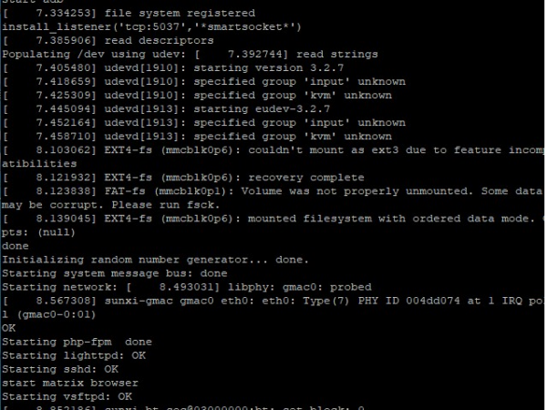

重新烧写img后开机logo及桌面都不显示,打印信息

发表于 2022-7-20 09:01:29 | 显示全部楼层
用的那个系统?哪一版本的资料?是T507吗?你可以将打印信息放到txt发来看下。

 楼主| 发表于 2022-7-20 09:05:40 | 显示全部楼层
okt507 Linux系统

[    5.095953] of_get_named_gpiod_flags: parsed 'cd-gpios' property of node '/soc@03000000/sdmmc@04020000[0]' - status (0)
[    5.095992] sunxi-mmc sdc0: Got CD GPIO
[    5.096001] sunxi-mmc sdc0: GPIO lookup for consumer wp
[    5.096006] sunxi-mmc sdc0: using device tree for GPIO lookup
[    5.096014] of_get_named_gpiod_flags: can't parse 'wp-gpios' property of node '/soc@03000000/sdmmc@04020000[0]'
[    5.096022] of_get_named_gpiod_flags: can't parse 'wp-gpio' property of node '/soc@03000000/sdmmc@04020000[0]'
[    5.096028] sunxi-mmc sdc0: using lookup tables for GPIO lookup
[    5.096034] sunxi-mmc sdc0: lookup for GPIO wp failed
[    5.096102] of_get_named_gpiod_flags: parsed 'cd-gpios' property of node '/soc@03000000/sdmmc@04020000[0]' - status (0)
[    5.096446] sunxi-mmc sdc0: sdc set ios:clk 0Hz bm PP pm UP vdd 22 width 1 timing LEGACY(SDR12) dt B
[    5.096486] sunxi-mmc sdc0: no vqmmc,Check if there is regulator
[    5.110120] sunxi-mmc sdc0: sdc set ios:clk 400000Hz bm PP pm ON vdd 22 width 1 timing LEGACY(SDR12) dt B
[    5.127153] sunxi-mmc sdc0: detmode:gpio irq
[    5.127899] sunxi-mmc sdc1: SD/MMC/SDIO Host Controller Driver(v3.44 2020-5-21 16:05-202006022045)
[    5.127988] sunxi-mmc sdc1: ***ctl-spec-caps*** 8
[    5.128197] sunxi-mmc sdc1: No vmmc regulator found
[    5.128203] sunxi-mmc sdc1: No vqmmc regulator found
[    5.128208] sunxi-mmc sdc1: No vdmmc regulator found
[    5.128213] sunxi-mmc sdc1: No vd33sw regulator found
[    5.128218] sunxi-mmc sdc1: No vd18sw regulator found
[    5.128223] sunxi-mmc sdc1: No vq33sw regulator found
[    5.128228] sunxi-mmc sdc1: No vq18sw regulator found
[    5.128240] of_get_named_gpiod_flags: can't parse 'card-pwr-gpios' property of node '/soc@03000000/sdmmc@04021000[0]'
[    5.128991] sunxi-mmc sdc1: set host busy
[    5.129018] sunxi-mmc sdc1: GPIO lookup for consumer cd
[    5.129024] sunxi-mmc sdc1: using device tree for GPIO lookup
[    5.129037] of_get_named_gpiod_flags: can't parse 'cd-gpios' property of node '/soc@03000000/sdmmc@04021000[0]'
[    5.129045] of_get_named_gpiod_flags: can't parse 'cd-gpio' property of node '/soc@03000000/sdmmc@04021000[0]'
[    5.129051] sunxi-mmc sdc1: using lookup tables for GPIO lookup
[    5.129058] sunxi-mmc sdc1: lookup for GPIO cd failed
[    5.129068] sunxi-mmc sdc1: GPIO lookup for consumer wp
[    5.129073] sunxi-mmc sdc1: using device tree for GPIO lookup
[    5.129081] of_get_named_gpiod_flags: can't parse 'wp-gpios' property of node '/soc@03000000/sdmmc@04021000[0]'
[    5.129088] of_get_named_gpiod_flags: can't parse 'wp-gpio' property of node '/soc@03000000/sdmmc@04021000[0]'
[    5.129093] sunxi-mmc sdc1: using lookup tables for GPIO lookup
[    5.129099] sunxi-mmc sdc1: lookup for GPIO wp failed
[    5.129151] of_get_named_gpiod_flags: can't parse 'cd-gpios' property of node '/soc@03000000/sdmmc@04021000[0]'
[    5.129154] mmc:failed to get gpios
[    5.129439] sunxi-mmc sdc1: sdc set ios:clk 0Hz bm PP pm UP vdd 21 width 1 timing LEGACY(SDR12) dt B
[    5.143528] sunxi-mmc sdc1: sdc set ios:clk 400000Hz bm PP pm ON vdd 21 width 1 timing LEGACY(SDR12) dt B
[    5.160207] sunxi-mmc sdc1: detmode:manually by software
[    5.161057] sunxi-mmc sdc1: smc 2 p1 err, cmd 52, RTO !!
[    5.161924] sunxi-mmc sdc1: smc 2 p1 err, cmd 52, RTO !!
[    5.161971] sunxi-mmc sdc1: sdc set ios:clk 400000Hz bm PP pm ON vdd 21 width 1 timing LEGACY(SDR12) dt B
[    5.163129] of_get_named_gpiod_flags: parsed 'gpios' property of node '/leds/user[0]' - status (0)
[    5.164498] sunxi-mmc sdc1: sdc set ios:clk 400000Hz bm PP pm ON vdd 21 width 1 timing LEGACY(SDR12) dt B
[    5.166485] sunxi-mmc sdc1: smc 2 p1 err, cmd 5, RTO !!
[    5.167380] sunxi-mmc sdc1: smc 2 p1 err, cmd 5, RTO !!
[    5.168262] sunxi-mmc sdc1: smc 2 p1 err, cmd 5, RTO !!
[    5.169123] sunxi-mmc sdc1: smc 2 p1 err, cmd 5, RTO !!
[    5.169159] sunxi-mmc sdc1: sdc set ios:clk 0Hz bm PP pm OFF vdd 0 width 1 timing LEGACY(SDR12) dt B
[    5.170275] sunxi-mmc sdc1: sdc set ios:clk 0Hz bm PP pm UP vdd 21 width 1 timing LEGACY(SDR12) dt B
[    5.176189] ledtrig-cpu: registered to indicate activity on CPUs
[    5.176365] hidraw: raw HID events driver (C) Jiri Kosina
[    5.182685] usbcore: registered new inte**ce driver usbhid
[    5.182690] usbhid: USB HID core driver
[    5.183146] ashmem: initialized
[    5.183529] logger: created 256K log 'log_main'
[    5.183853] logger: created 256K log 'log_events'
[    5.184141] logger: created 256K log 'log_radio'
[    5.184402] logger: created 256K log 'log_system'
[    5.186653] hello word
[    5.186653] usbcore: registered new inte**ce driver snd-usb-audio
[    5.186836] sunxi-mmc sdc1: sdc set ios:clk 300000Hz bm PP pm ON vdd 21 width 1 timing LEGACY(SDR12) dt B
[    5.193656] [sunxi_hdmi_codec_init] driver and deivce register finished.
[    5.195964] codec supply avcc not found, using dummy regulator
[    5.196075] codec supply vcc33_audio not found, using dummy regulator
[    5.196443] of_get_named_gpiod_flags: can't parse 'gpio-spk' property of node '/soc@03000000/codec@0x05096000[0]'
[    5.196453] lineout_vol:26, linein_gain:3, fmin_gain:3, digital_vol:0, adcdrc_cfg:0, adchpf_cfg:0, dacdrc_cfg:0, dachpf_cfg:0, ramp_func_used:1, pa_msleep_time:120, pa_ctl_level:0, gpio-spk:0
[    5.198531] sunxi-codec-machine sndcodec: sun50iw9-codec <-> cpudai mapping ok
[    5.201051] sndhdmi sndhdmi: ASoC: CPU DAI (null) not registered
[    5.201060] sndhdmi sndhdmi: snd_soc_register_card() failed: -517
[    5.204132] sunxi-ahub-cpudai 5097000.cpudai3-controller: ahub cpudai id invalid
[    5.204155] sunxi-ahub-cpudai: probe of 5097000.cpudai3-controller failed with error -22
[    5.204593] sunxi-mmc sdc1: smc 2 p1 err, cmd 52, RTO !!
[    5.205717] sunxi-mmc sdc1: smc 2 p1 err, cmd 52, RTO !!
[    5.205768] sunxi-mmc sdc1: sdc set ios:clk 300000Hz bm PP pm ON vdd 21 width 1 timing LEGACY(SDR12) dt B
[    5.208427] sunxi-mmc sdc1: sdc set ios:clk 300000Hz bm PP pm ON vdd 21 width 1 timing LEGACY(SDR12) dt B
[    5.208487] sndahub sndahub: sunxi-ahub-aif1 <-> 5097000.cpudai0-controller mapping ok
[    5.209095] sndahub sndahub: sunxi-ahub-aif2 <-> 5097000.cpudai1-controller mapping ok
[    5.210142] sndahub sndahub: sunxi-ahub-aif3 <-> 5097000.cpudai2-controller mapping ok
[    5.210651] sunxi-mmc sdc1: smc 2 p1 err, cmd 5, RTO !!
[    5.211801] sunxi-mmc sdc1: smc 2 p1 err, cmd 5, RTO !!
[    5.212957] sunxi-mmc sdc1: smc 2 p1 err, cmd 5, RTO !!
[    5.213758] u32 classifier
[    5.213762]     Actions configured
[    5.213772] Netfilter messages via NETLINK v0.30.
[    5.213790] nfnl_acct: registering with nfnetlink.
[    5.214078] sunxi-mmc sdc1: smc 2 p1 err, cmd 5, RTO !!
[    5.214123] sunxi-mmc sdc1: sdc set ios:clk 0Hz bm PP pm OFF vdd 0 width 1 timing LEGACY(SDR12) dt B
[    5.214251] nf_conntrack version 0.5.0 (16384 buckets, 65536 max)
[    5.214536] ctnetlink v0.93: registering with nfnetlink.
[    5.215218] xt_time: kernel timezone is -0000
[    5.215251] sunxi-mmc sdc1: sdc set ios:clk 0Hz bm PP pm UP vdd 21 width 1 timing LEGACY(SDR12) dt B
[    5.215340] ipip: IPv4 and MPLS over IPv4 tunneling driver
[    5.216145] gre: GRE over IPv4 demultiplexor driver
[    5.216151] ip_gre: GRE over IPv4 tunneling driver
[    5.217707] IPv4 over IPsec tunneling driver
[    5.222233] ip_tables: (C) 2000-2006 Netfilter Core Team
[    5.229298] arp_tables: arp_tables: (C) 2002 David S. Miller
[    5.233462] sunxi-mmc sdc1: sdc set ios:clk 200000Hz bm PP pm ON vdd 21 width 1 timing LEGACY(SDR12) dt B
[    5.244638] Initializing XFRM netlink socket
[    5.244677] IPsec XFRM device driver
[    5.245608] NET: Registered protocol family 10
[    5.248113] mip6: Mobile IPv6
[    5.248155] ip6_tables: (C) 2000-2006 Netfilter Core Team
[    5.251758] sunxi-mmc sdc1: smc 2 p1 err, cmd 52, RTO !!
[    5.253392] sunxi-mmc sdc1: smc 2 p1 err, cmd 52, RTO !!
[    5.253427] sunxi-mmc sdc1: sdc set ios:clk 200000Hz bm PP pm ON vdd 21 width 1 timing LEGACY(SDR12) dt B
[    5.256322] sunxi-mmc sdc1: sdc set ios:clk 200000Hz bm PP pm ON vdd 21 width 1 timing LEGACY(SDR12) dt B
[    5.259031] sunxi-mmc sdc1: smc 2 p1 err, cmd 5, RTO !!
[    5.260660] sunxi-mmc sdc1: smc 2 p1 err, cmd 5, RTO !!
[    5.262285] sunxi-mmc sdc1: smc 2 p1 err, cmd 5, RTO !!
[    5.263910] sunxi-mmc sdc1: smc 2 p1 err, cmd 5, RTO !!
[    5.263934] sunxi-mmc sdc1: sdc set ios:clk 0Hz bm PP pm OFF vdd 0 width 1 timing LEGACY(SDR12) dt B
[    5.265052] sunxi-mmc sdc1: sdc set ios:clk 0Hz bm PP pm UP vdd 21 width 1 timing LEGACY(SDR12) dt B
[    5.266921] sit: IPv6, IPv4 and MPLS over IPv4 tunneling driver
[    5.268815] NET: Registered protocol family 17
[    5.268859] NET: Registered protocol family 15
[    5.269018] Bluetooth: RFCOMM socket layer initialized
[    5.269052] Bluetooth: RFCOMM ver 1.11
[    5.269067] Bluetooth: BNEP (Ethernet Emulation) ver 1.3
[    5.269071] Bluetooth: BNEP filters: protocol multicast
[    5.269083] Bluetooth: BNEP socket layer initialized
[    5.269088] Bluetooth: HIDP (Human Inte**ce Emulation) ver 1.2
[    5.269099] Bluetooth: HIDP socket layer initialized
[    5.269138] l2tp_core: L2TP core driver, V2.0
[    5.269153] l2tp_ppp: PPPoL2TP kernel driver, V2.0
[    5.271118] Registered cp15_barrier emulation handler
[    5.271130] Registered setend emulation handler
[    5.272224] registered taskstats version 1
[    5.280216] sunxi-mmc sdc1: sdc set ios:clk 100000Hz bm PP pm ON vdd 21 width 1 timing LEGACY(SDR12) dt B
[    5.283234] of_get_named_gpiod_flags: parsed 'gpio' property of node '/codec-power[0]' - status (0)
[    5.289763] cpu cpu1: opp_list_debug_create_link: Failed to create link
[    5.289772] cpu cpu1: _add_opp_dev: Failed to register opp debugfs (-12)
[    5.289810] cpu cpu2: opp_list_debug_create_link: Failed to create link
[    5.289816] cpu cpu2: _add_opp_dev: Failed to register opp debugfs (-12)
[    5.289853] cpu cpu3: opp_list_debug_create_link: Failed to create link
[    5.289859] cpu cpu3: _add_opp_dev: Failed to register opp debugfs (-12)
[    5.293714] sndhdmi sndhdmi: audiohdmi-dai <-> sunxi-ahub-cpu-aif1 mapping ok
[    5.294762] of_get_named_gpiod_flags: parsed 'usb_det_vbus_gpio' property of node '/soc@03000000/usbc0@0[0]' - status (0)
[    5.294779] of_get_named_gpiod_flags: parsed 'usb_id_gpio' property of node '/soc@03000000/usbc0@0[0]' - status (0)
[    5.299582] rtc-rx8010 3-0032: setting system clock to 2021-09-21 17:00:41 UTC (1632243641)
[    5.300011] sunxi-mmc sdc1: smc 2 p1 err, cmd 52, RTO !!
[    5.300474] snddaudio snddaudio3: codec: wm8960.3-001a, codec_dai: wm8960-hifi.
[    5.301066] snddaudio snddaudio3: wm8960-hifi <-> sunxi-ahub-cpu-aif3 mapping ok
[    5.303270] sunxi-mmc sdc1: smc 2 p1 err, cmd 52, RTO !!
[    5.303299] sunxi-mmc sdc1: sdc set ios:clk 100000Hz bm PP pm ON vdd 21 width 1 timing LEGACY(SDR12) dt B
[    5.306940] sunxi-mmc sdc1: sdc set ios:clk 100000Hz bm PP pm ON vdd 21 width 1 timing LEGACY(SDR12) dt B
[    5.311281] sunxi-mmc sdc1: smc 2 p1 err, cmd 5, RTO !!
[    5.314500] sunxi-mmc sdc1: smc 2 p1 err, cmd 5, RTO !!
[    5.317725] sunxi-mmc sdc1: smc 2 p1 err, cmd 5, RTO !!
[    5.320950] sunxi-mmc sdc1: smc 2 p1 err, cmd 5, RTO !!
[    5.320971] sunxi-mmc sdc1: sdc set ios:clk 0Hz bm PP pm OFF vdd 0 width 1 timing LEGACY(SDR12) dt B
[    5.330111] sunxi-mmc sdc0: sdc set ios:clk 0Hz bm PP pm OFF vdd 0 width 1 timing LEGACY(SDR12) dt B
[    5.409695] otg-vbus: disabling
[    5.410106] axp858-dcdc4: disabling
[    5.411451] axp858-aldo3: disabling
[    5.414560] ALSA device list:
[    5.414564]   #0: audiocodec
[    5.414566]   #1: sndahub
[    5.414568]   #2: sndhdmi
[    5.414571]   #3: sndwm8960.3-001a
[    5.416700] Freeing unused kernel memory: 4352K
[    6.310442] sunxi-mmc sdc2: sdc set ios:clk 400000Hz bm PP pm ON vdd 21 width 8 timing LEGACY(SDR12) dt B
[/init]: getty is ttyS0
[/init]: RootDevice is "/dev/mmcblk0p4" , GPT_SUPPORT=1
[/init]: Try to load EMMC ...
[/init]: Wait /dev/mmcblk0p4 ready ...[    6.323669] sunxi-mmc sdc2: sdc set ios:clk 400000Hz bm PP pm ON vdd 21 width 8 timing MMC-HS200 dt B
[    6.345170] sunxi-mmc sdc2: sdc set ios:clk 100000000Hz bm PP pm ON vdd 21 width 8 timing MMC-HS200 dt B
[    6.356091] sunxi-mmc sdc2: sdc set ios:clk 100000000Hz bm PP pm ON vdd 21 width 8 timing MMC-HS(SDR20) dt B
[    6.367311] sunxi-mmc sdc2: sdc set ios:clk 52000000Hz bm PP pm ON vdd 21 width 8 timing MMC-HS(SDR20) dt B
[    6.378433] sunxi-mmc sdc2: sdc set ios:clk 50000000Hz bm PP pm ON vdd 21 width 8 timing MMC-HS400 dt B
[    6.389078] sunxi_mmc_get_hs400_cmd_dly,222
[    6.393768] sunxi-mmc sdc2: failed to get HS400_cmd used default
[    6.400564] sunxi-mmc sdc2: sdc set ios:clk 100000000Hz bm PP pm ON vdd 21 width 8 timing MMC-HS400 dt B
[    6.411321] sunxi_mmc_get_hs400_cmd_dly,222
[    6.416033] sunxi-mmc sdc2: failed to get HS400_cmd used default
[    6.422992] mmc0: new HS400 MMC card at address 0001
[    6.429265] mmcblk0: mmc0:0001 88A398 7.28 GiB
[    6.434747] mmcblk0boot0: mmc0:0001 88A398 partition 1 4.00 MiB
[    6.441679] mmcblk0boot1: mmc0:0001 88A398 partition 2 4.00 MiB
[    6.448727] mmcblk0rpmb: mmc0:0001 88A398 partition 3 4.00 MiB
[    6.457545]  mmcblk0: p1 p2 p3 p4 p5 p6
e2fsck 1.42.12 (29-Aug-2014)
/dev/mmcblk0p4: recovering journal
Setting free blocks count to 365823 (was 365824)
/dev/mmcblk0p4: clean, 5347/131072 files, 158465/524288 blocks
[    7.356905] EXT4-fs (mmcblk0p4): barriers disabled
[    7.366185] EXT4-fs (mmcblk0p4): mounted filesystem with ordered data mode. Opts: noauto_da_alloc,barrier=0,data=ordered
Starting syslogd: OK
Starting klogd: OK
start adb
[    7.576342] file system registered
install_listener('tcp:5037','*smartsocket*')
[    7.628097] read descriptors
Populating /dev using udev: [    7.634988] read strings
[    7.650395] udevd[1641]: starting version 3.2.7
[    7.662741] udevd[1641]: specified group 'input' unknown
[    7.669263] udevd[1641]: specified group 'kvm' unknown
[    7.687320] udevd[1644]: starting eudev-3.2.7
[    7.694272] udevd[1644]: specified group 'input' unknown
[    7.700778] udevd[1644]: specified group 'kvm' unknown
[    8.346057] EXT4-fs (mmcblk0p6): couldn't mount as ext3 due to feature incompatibilities
[    8.359113] EXT4-fs (mmcblk0p6): recovery complete
[    8.364167] FAT-fs (mmcblk0p1): Volume was not properly unmounted. Some data may be corrupt. Please run fsck.
[    8.375767] EXT4-fs (mmcblk0p6): mounted filesystem with ordered data mode. Opts: (null)
done
Initializing random number generator... done.
Starting system message bus: done
Starting network: [    8.719452] libphy: gmac0: probed
[    8.790488] sunxi-gmac gmac0 eth0: eth0: Type(7) PHY ID 004dd074 at 1 IRQ poll (gmac0-0:01)
OK
Starting php-fpm  done
Starting lighttpd: OK
Starting sshd: OK
start matrix browser
Starting vsftpd: OK
[    9.068333] sunxi-bt soc@03000000:bt: set block: 0
[    9.092755] of_get_named_gpiod_flags: parsed 'bt_hostwake' property of node '/soc@03000000/btlpm[0]' - status (0)
[    9.104497] of_get_named_gpiod_flags: parsed 'bt_wake' property of node '/soc@03000000/btlpm[0]' - status (0)
Loading /var/lib/alsa/asound.state
[    9.349409] mali_kbase: loading out-of-tree module taints kernel.
[    9.380910] mali gpu: Regulators probed: 1
[    9.385696] mali gpu: Clocks probed: 2
[    9.393223] mali gpu: [960mv-648MHz] bak[950mv-600MHz] inde_power:1 idle:0 dvfs:0
[    9.404462] mali gpu: GPU identified as 0x3 arch 7.0.9 r0p0 status 0
[    9.411996] mali gpu: No memory group manager is configured
[    9.419680] mali gpu: Using configured power model mali-**-power-model, and fallback mali-**-power-model
[    9.432418] mali gpu: Probed as mali0
# Attribute Qt::AA_ShareOpenGLContexts must be set before QCoreApplication is created.
[   11.650196]
[   11.650196] insmod_device_driver
[   11.650196]
[   11.876457] android_work: sent uevent USB_STATE=CONNECTED
[   11.898048] configfs-gadget gadget: high-speed config #1: c
[   11.904475] android_work: sent uevent USB_STATE=CONFIGURED
目前打印信息看没什么问题,是不是你屏幕没接好?换个屏幕呢?或者你拍个屏幕照片  详情 回复 发表于 2022-7-20 09:34

发表于 2022-7-20 09:30:58 | 显示全部楼层
zchong123 发表于 2022-7-20 09:12
# [80]HELLO! BOOT0 is starting!
[83]BOOT0 commit : ebd76fd
[86]set pll start
用的那一版资料?烧的什么日期镜像?文件夹上面写着日期呢

发表于 2022-7-20 09:34:01 | 显示全部楼层
[86]set pll start
