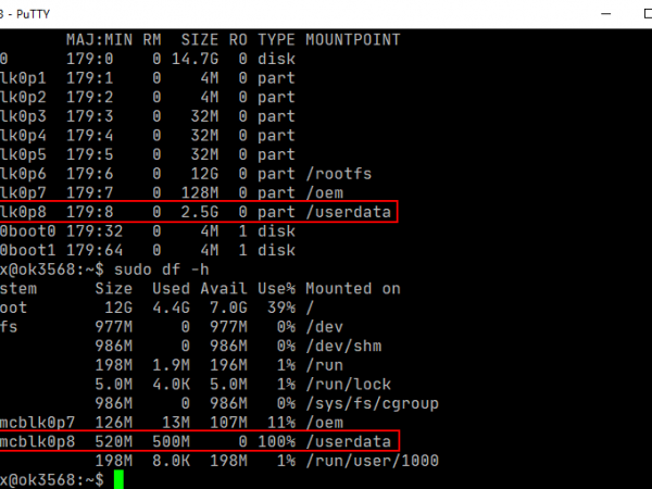

mmcblk0p8分区是2.5GB,挂载在/userdata ; 但看到/userdata已经占用了500MB,使用率100%;
mmcblk0p8的2GB空间去哪里了? 还是可以继续在/userdata下放2GB的用户个人数据文件?

resize2fs /dev/mmcblk0p8
文件系统误认为100%了,执行这个进行实际检测同步下大小

解决了,多谢!
tmpfs           198M  1.9M  196M   1% /run
tmpfs           5.0M  4.0K  5.0M   1% /run/lock
tmpfs           986M     0  986M   0% /sys/fs/cgroup
/dev/mmcblk0p7  126M   13M  107M  11% /oem
/dev/mmcblk0p8  520M  500M     0 100% /userdata
tmpfs           198M   12K  198M   1% /run/user/1000
forlinx@ok3568:~$ sudo resize2fs /dev/mmcblk0p8
resize2fs 1.45.5 (07-Jan-2020)
Filesystem at /dev/mmcblk0p8 is mounted on /userdata; on-line resizing required
old_desc_blocks = 1, new_desc_blocks = 1
The filesystem on /dev/mmcblk0p8 is now 639992 (4k) blocks long.
forlinx@ok3568:~$ sudo df -h
Filesystem      Size  Used Avail Use% Mounted on
/dev/root        12G  4.4G  6.9G  40% /
devtmpfs        977M     0  977M   0% /dev
tmpfs           986M     0  986M   0% /dev/shm
/dev/mmcblk0p8  2.5G  500M  1.9G  22% /userdata
forlinx@ok3568:~$
