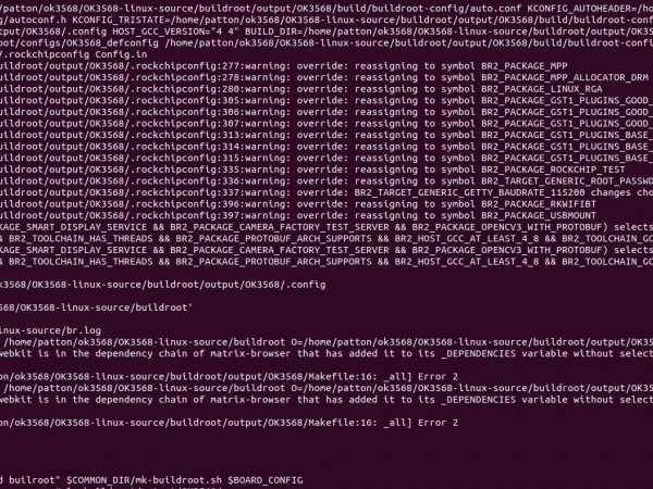

已解决:GCC 版本太低
全编译 LINUX 4.19.206
使用 ./build.sh 报错 ,这是什么问题?
最后别建议用你们的开发环境,手头好多个项目在开发,每个项目都下载一个开发环境,多大的硬盘也存不下啊!:L
2023-11-21T01:52:06 umask 0022 && make -C /home/patton/ok3568/OK3568-linux-source/buildroot O=/home/patton/ok3568/OK3568-linux-source/buildroot/output/OK3568
2023-11-21T01:52:12 Makefile:552: *** qt5webkit is in the dependency chain of matrix-browser that has added it to its _DEPENDENCIES variable without selecting it or depending on it from Config.in.  Stop.
2023-11-21T01:52:12 make: *** [/home/patton/ok3568/OK3568-linux-source/buildroot/output/OK3568/Makefile:16: _all] Error 2
2023-11-21T10:24:07 umask 0022 && make -C /home/patton/ok3568/OK3568-linux-source/buildroot O=/home/patton/ok3568/OK3568-linux-source/buildroot/output/OK3568
2023-11-21T10:24:13 Makefile:552: *** qt5webkit is in the dependency chain of matrix-browser that has added it to its _DEPENDENCIES variable without selecting it or depending on it from Config.in.  Stop.
2023-11-21T10:24:13 make: *** [/home/patton/ok3568/OK3568-linux-source/buildroot/output/OK3568/Makefile:16: _all] Error 2
