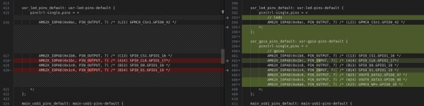

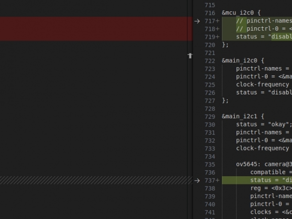

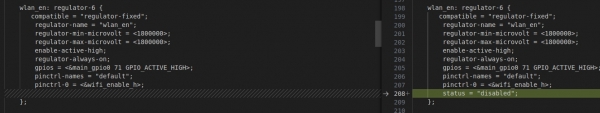

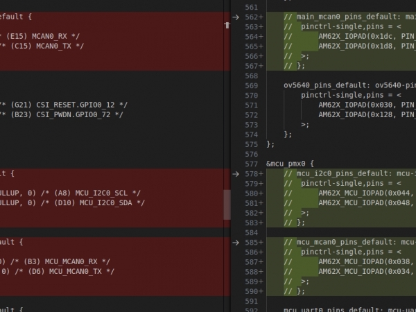

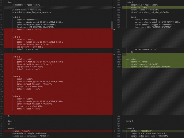

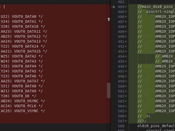

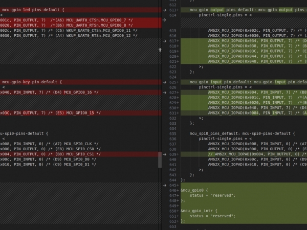

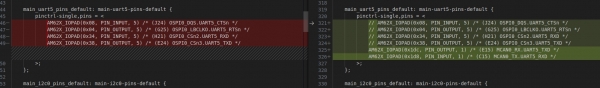

请问基于OK6321-C的核心板开发的硬件,A核的GPIO无法拉高是怎么回事儿呢?,比如引脚(W24) VOUT0_DATA3.GPIO0_48,测试结果如下图所示,哪怕外接了上拉电阻也不行
(具体修改见zip文件)
主要是修改设备树文件:arch/arm64/boot/dts/ti/OK62xx.dtsi
以防万一没有改完,把下面的设备树文件也做了修改:
arch/arm64/boot/dts/ti/OK6231-C-lvds.dtso
arch/arm64/boot/dts/ti/OK6231-C-rgb-lvds-dual.dtso
arch/arm64/boot/dts/ti/OK6231-C-rgb.dtso
arch/arm64/boot/dts/ti/k3-am625-beagleplay.dts
arch/arm64/boot/dts/ti/k3-am62x-sk-common.dtsi
把这个文件内的节点disabled掉试一试
&dss {
        pinctrl-names = "default";
        pinctrl-0 = <&oldi0_pins_default &main_dss0_pins_default>;
        status = "disabled";
